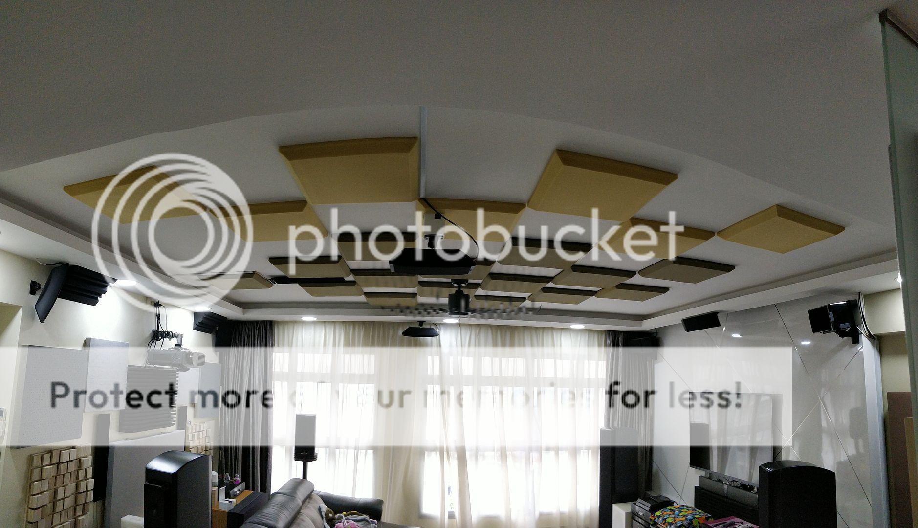

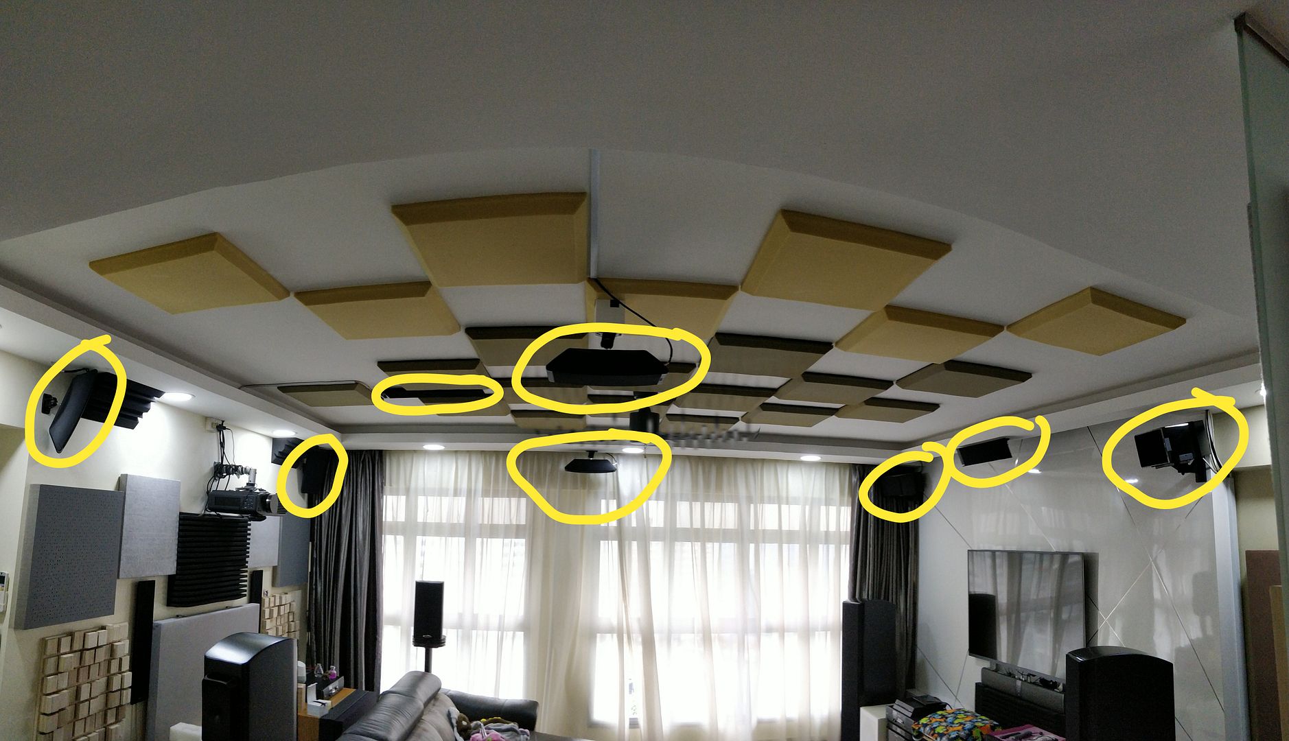

Point 1.
I started off with Auro3D format layout, since i can achieve the sound bubble of DTS:X as well as Auro3D with Top surround VOG and Center Height. I thought i can get away when introducing Atmos by "matrixing" them....This proves me wrong because nothing can beat the sound FROM the correct speaker placement according to guidelines. Following as close as i can get with WAF, the result in what i've achieved are not only having DTS:X as well as Auro3D with Top surround VOG and center height, but also Atmos.
I've added top middle left and right speakers so atmos can be played from the respective speakers :P
So in total, i am having 8 height speakers. Front heights and rear heights for DTS:X, Auro3D, Atmos, Top middle for Atmos, and finally VOG and center height for Auro3D. This is done so that i can enjoy all sound formats.

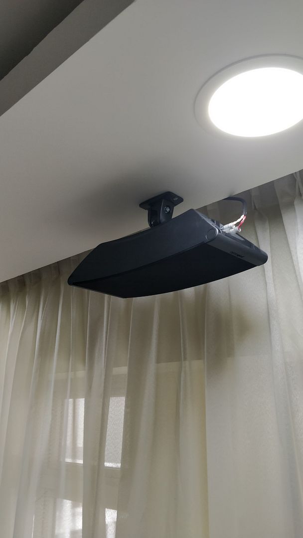

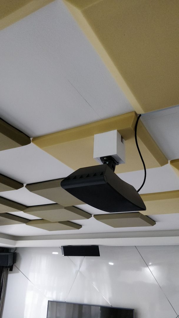

Here is the close up for the top middle left
Here is the close up for top middle right. Now because i wanted to make sure top middle right is the same level as my top middle left which is mounted onto false ceiling, i made one block same drop down length so that the same measurement and distance can be properly measure by room correction software audyssey.
Overall experience improves because Atmos can be properly played to its respective channel.

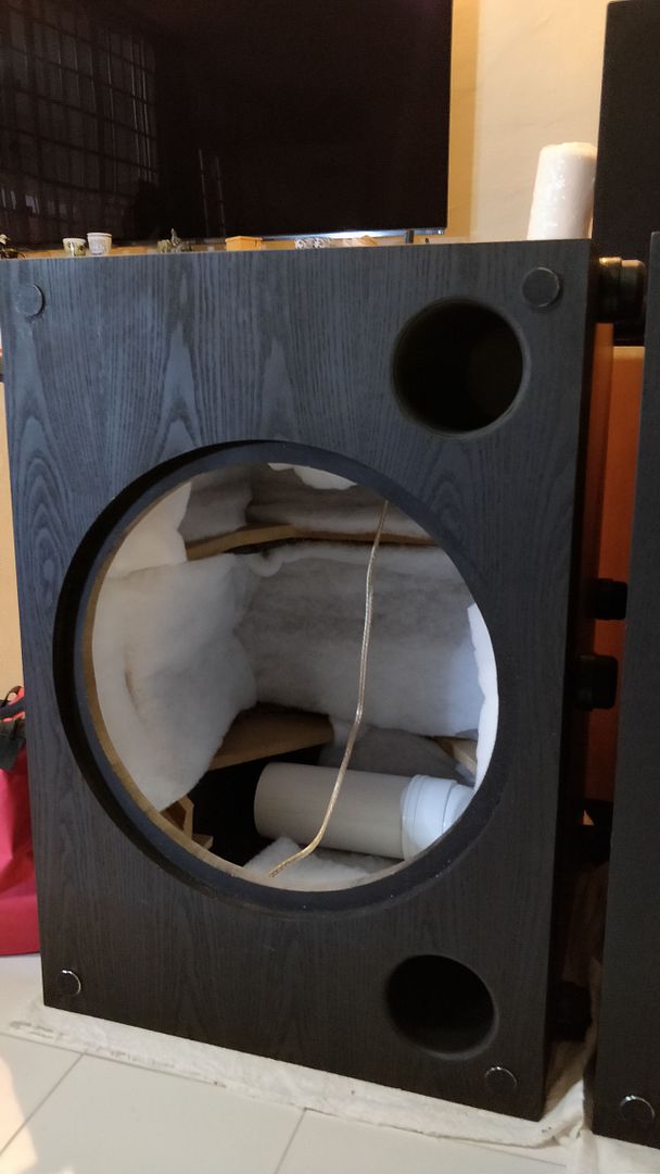

The main reason why i change cabinet size is to reduce the potential/slightest chance of port chuffing. After heeding a bro advice wechnivag, i decided to go for it to make a change of the cabinet that has been with me for the past 4 years coming 5.
This is the original cab with one port. Dismantling the subwoofer driver (TC Sound ultra 5400) is never easy due to its weight. Thanks to bro synthesis help in this. i can rem him saying, "the first time i did this cab i find it massive, now it seems a norm to me" lol... experience level up there i see.
The below is the final result of the "upgraded cab". With 2 ports now, playing edge of tomorrow will bring my neighbors come knocking on my door. :P
The subs are powered by the Behringer NX6000D DSP Class D power amp. (a bit of ko yoh here, we are the dealer for this lol)
Overall experience again improves. Digs deeper, prevents chuffing noise, more extensions i guess :)  gotta special thanks for kennyluck here. Due to my tennis elbow on my left arm, he is really super duper kind to help me send back the cabs and put back the drivers, yet got his finger hurt. 😓 Sincerely thank you Kenny!!!

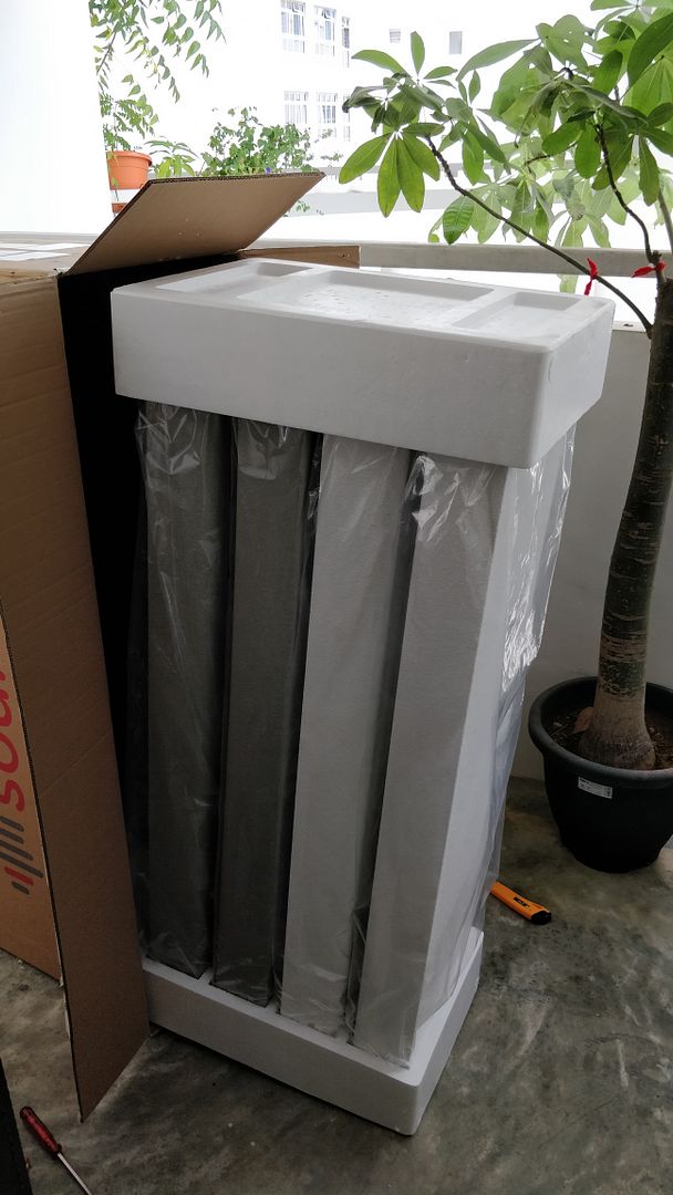

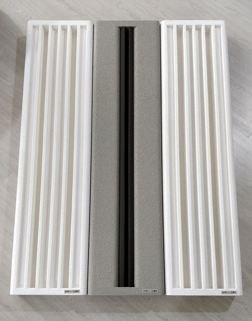

Being skeptical about having diffusers then, what i have in my living hall are only absorbers. so what makes me think twice about having them... bro ronildoq's setup!! Hear to believe! No doubt absorbers, curtains, fabric sofas etc etc can reduce noise floors, too much of it makes the room sound dead.
Having a low noise floor brings out the finest details even at a lower listening volume, which what bro ronildoq and bro desray says (i believe majority of us would agree), reduces listening fatigue and at the same time can still have decent conversation when movie is playing. Now the magic of having diffusers are, despite the room sounding "dead" without any movie playing in the living hall, everything comes so much alive the moment a movie started. Sound dispersion, the environments, the sound panning all around MLP leaving minor to no sound gaps, listen to stereo, stereo music sounded so much like also coming from surround speakers, the WHOLE experience just up by another level (well maybe a little level).
This is unboxing picture. (yes, another bit of ko yoh here again lol, we are the only dealer for soundbox acoustic in SG lol)
The specs as below in brief for the white color:
-Material made of Polymer (with large molecules) with E0 Eco friendly paint over
-Full band frequency diffuser
-QRD arrays
-Improves sound fullness and surroundings sense without hurting natural RT60
-size is H1.2m x W30cm x D10cm weighing less than 2.8KG per piece.
The specs as below in brief for the grey color:
-Medium frequency absorber
-Polymer/polyether polyol fire retardant acoustic foam in between
-Deal with low freq around 300hz to 800hz
-size is H1.2m x W30cm x D10cm weighing less than 1.6KG per piece.

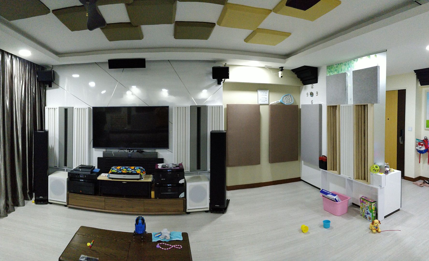

This is the before treatment pic
This is the after treatment pic
This is the overall front stage pic (just imagine flat wall and my glass partition all around :D)
Overall experience definitely improves by leaps and bounds! Sound gaps between speakers become narrower, sound panning between speakers improved thus sound is more immersive, stereo sound stage widens, it becomes more alive and is like listening with surrounds speakers but yet only stereo, all while remaining a low noise floor!
