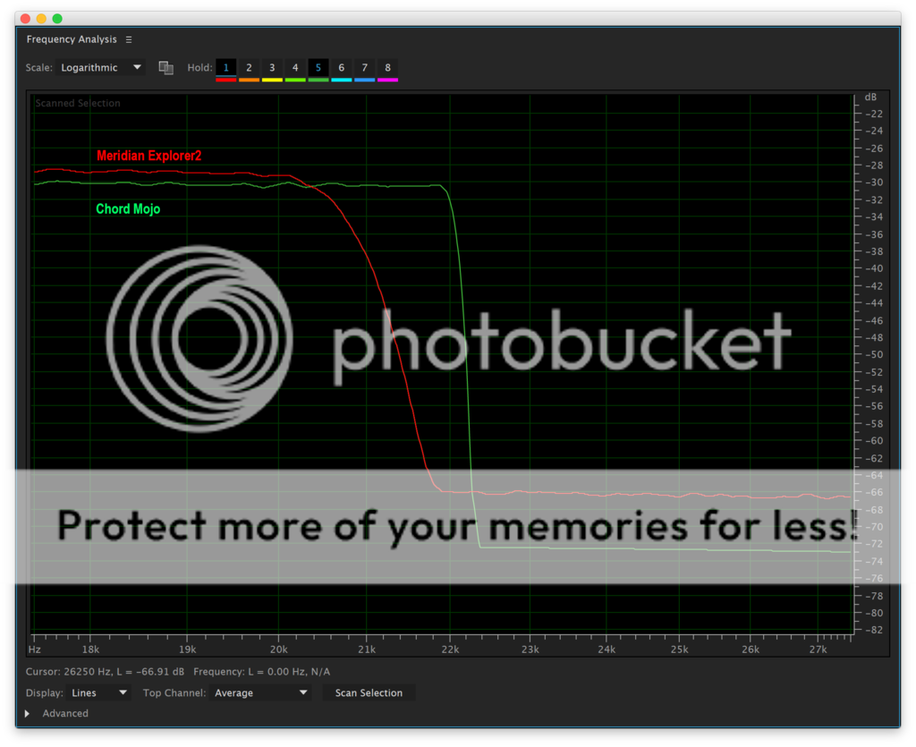

JA’s measurement section strangely doesn’t include a standalone frequency response chart (all other recent DAC reviews do)…  So after the hour of run-in, I did a frequency response measurement which didn’t look especially out of the ordinary (except for the interestingly different responses for the various sample rates). A closer look at the 44.1k sample-rate response though, compared to the Chord Mojo’s response, starts to hint at the issue…
The Explorer2’s roll-off from 20kHz (Red) is gentle slope which suggests it’s non-linear apodizing nature, all good, but it starts almost right at 20kHz which, depending on the filter type, could have repercussions at lower octaves. I also checked the impulse response (a one-sample 44.1k/16bit -3dBFS pulse), which shows a classic Meridian apodizing FIR filter response with no pre-ringing, but a very long ringing tail.

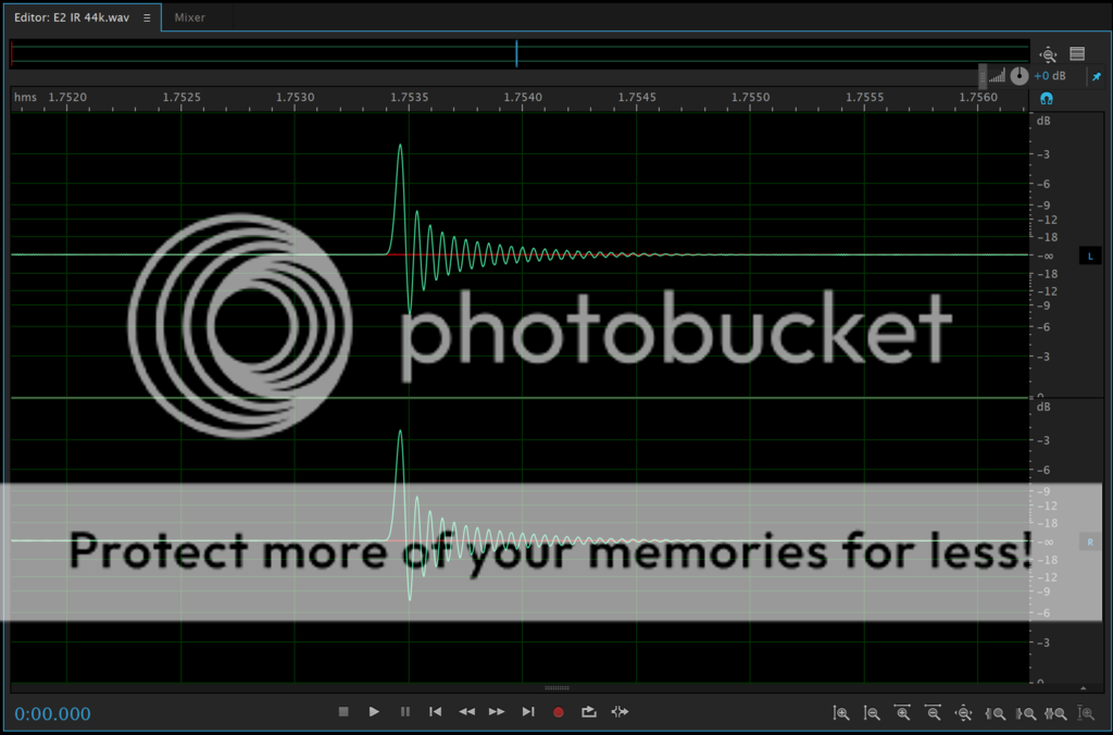

In JA’s measurement, he compared the Impulse Response of the original Explorer versus Explorer2 (Figure 1, vs. Figure 2 respectively). Strangely, my measurement shows my Explorer2 behaving like an original Explorer! Specifically, nearly a millisecond long post-impulse ringing, instead of about a-third of a millisecond (according to JA’s measurement anyway).
Have a look;
I wondered if it was something mistaken with my measurement/method, but I crossed checked against previous measurements taken on my other DACs at home, both linear and non-linear filters with shorter durations.
So, whatever firmware Stereophile received and JA measured with their Explorer2, seems like it’s not what the rest of us consumers are getting :o

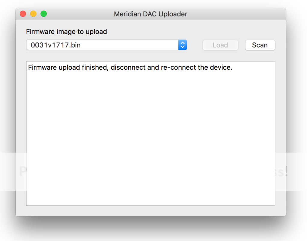

Even though the Explorer2 came with updated MQA firmware, I re-flashed the firmware anyway using Meridian’s dedicated App.
There wasn’t any appreciable difference even after the update; an overwhelming sense of a veiled and rolled-off sound, and the impulse response wasn’t changed either. Something’s definitely off.
